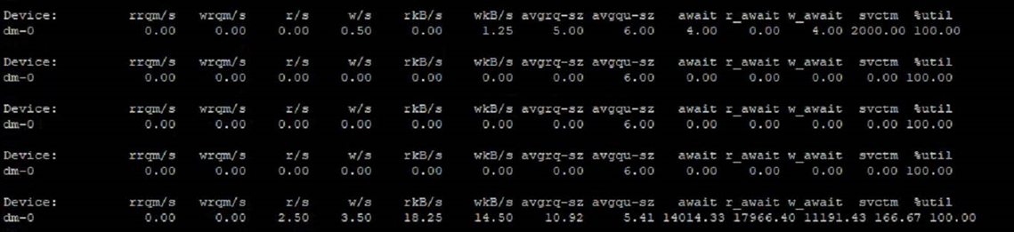

3. Check whether the storage is normal:Perform iostat to check the storage delay and busy degree. It is found that the% util of dm-0 storage volume reaches 100%, the disk is busy, there are many I / O requests, and it runs at full load.

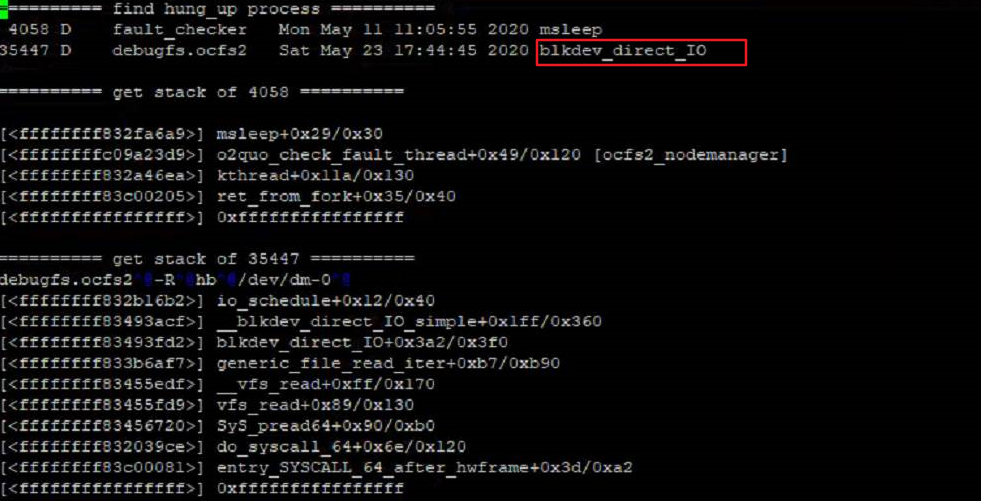

4. Confirm whether there is cluster lock :ssh to cvk shell line and execute OCFS2_ kernel_ stat_ collect.sh command to check whether there is a hung up process.As shown in the figure below, it is found that there is a hung up process and dm-0 is busy printing. A similar log file named cvk01_ ocfs2_ kernel_ state_ 202005231721.log is generated in the / var / log directory. The log file contains the following logs. It is preliminarily judged that IO is blocked

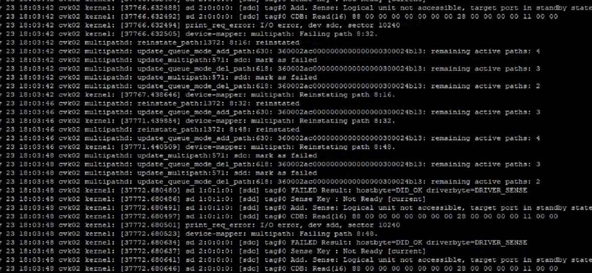

5. Check the syslog log log:there are a large number of links concussion, multi-path connection failure print, so we can judge the storage failure

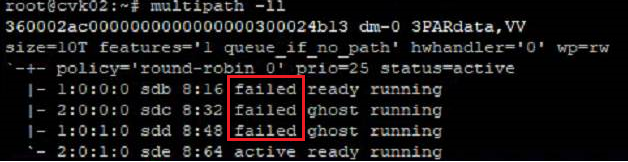

6. Multipath - ll view multipath, with failed print
