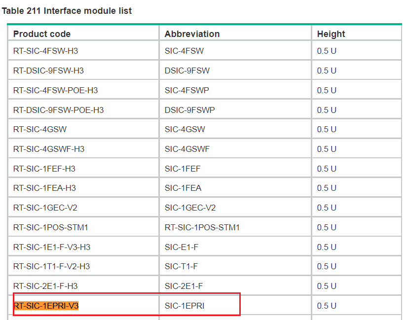

1. First check the MSR installation manual, you can see from the Appendix A Interface module list that SIC-1EPRI is the abbreviation of RT-SIC-1EPRI-V3.

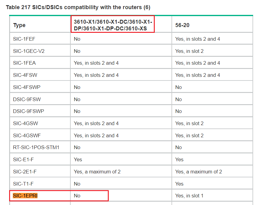

2. Check Table 217 SICs/DSICs compatibility with the routers (6), you can see that SIC-1EPRI is not compatible with MSR3610-X1.
Solution
This interface card is not supported by MSR3610-X1.
