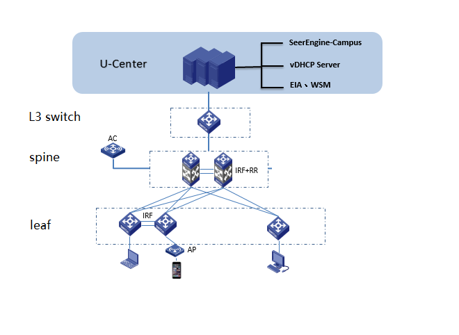

Network Topology
Topology:
The connection between the L3 switch and vDHCP is over layer 3.
