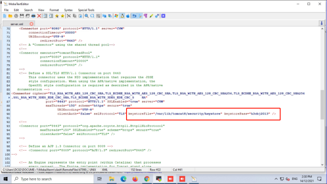

<Connector port="8443" protocol="org.apache.coyote.http11.Http11Protocol"
               maxThreads="150" SSLEnabled="true" scheme="https" secure="true"
               clientAuth="false" sslProtocol="TLS"
                             keystoreFile="conf/server.jks"
                             keystorePass="password which you set"/>

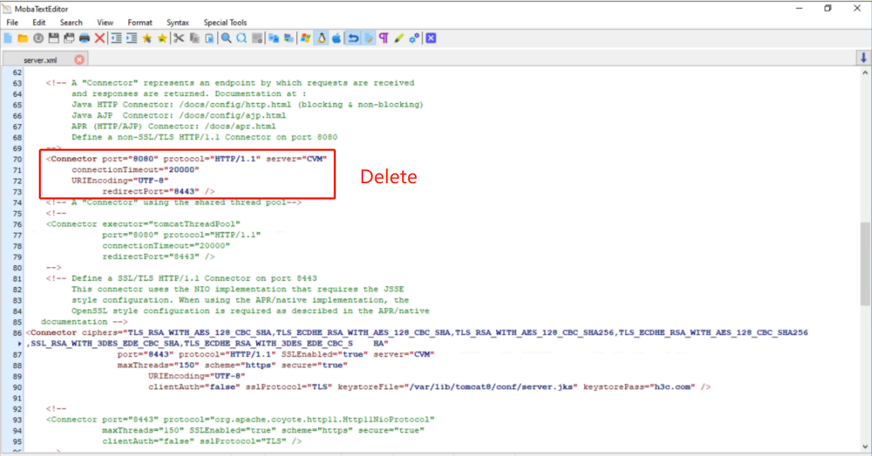

4.Invalidating port 8080 (need to do this on all cvm)
Modify conf/server.xml configuration file, for example:
delete <connect port="8080">, just like the figure:
