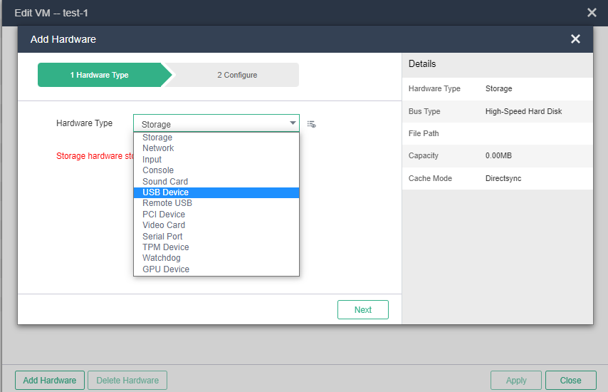

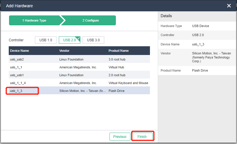

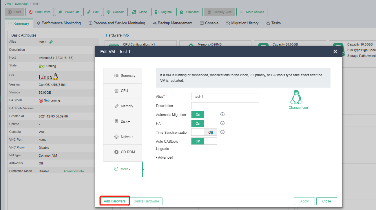

Plug the USB into the host where the virtual machine is located, then modify the virtual machine where the data is located in the UIs foreground, bind the inserted USB flash disk

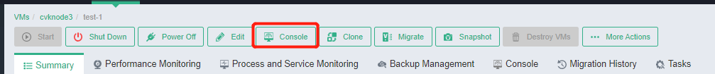

 And then, log in to the VM through the Console
After entering the windows system, "my computer" can see the bound USB, and the file can be transferred by normal copy and paste operations.

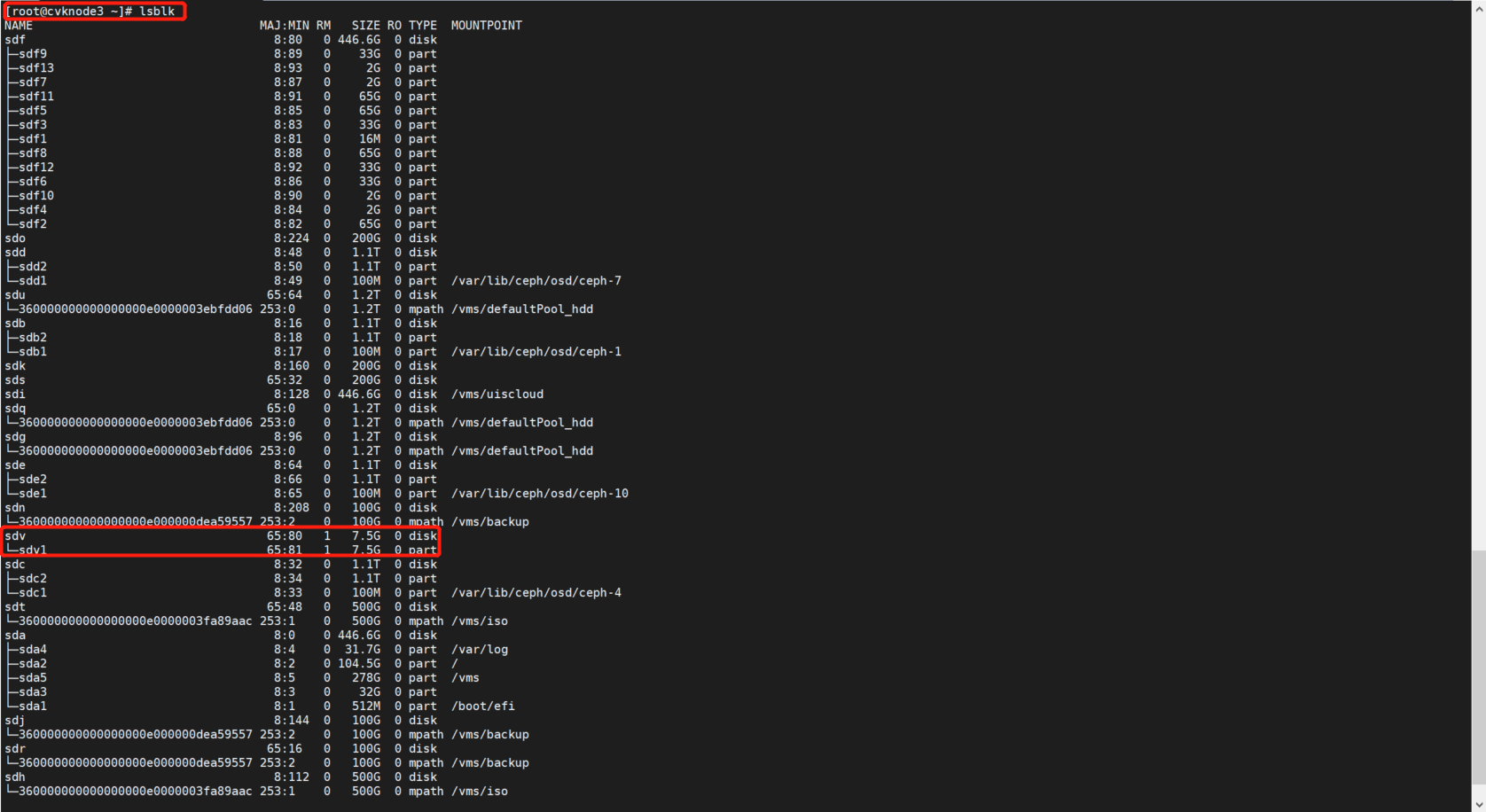

Enter the Linux system after binding in the same way as above,view the added USB through the command: lsblk
Run the following command to locate the disk file path where the VM resides and the file you want to copy is under the source data folder:cp file name destination folder —————— You can copy files to the destination folder.
