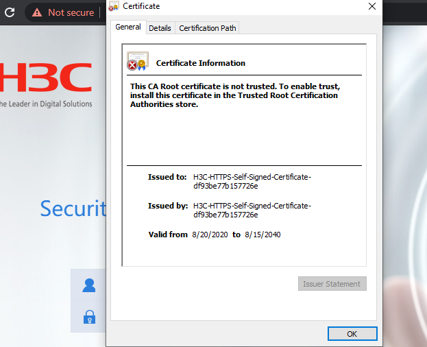

Problem Description
The web interface prompts not secure when managing the firewall remotely with HTTPS, how to solve it?
Process Analysis
The device uses a self-signed certificate (a certificate that is generated and signed by the device itself) and the default SSL settings. The device operates in simplified mode after you enable HTTPS service on the device by default.
So it will prompt that it is not secure and you need to import the trusted certificate yourself.
