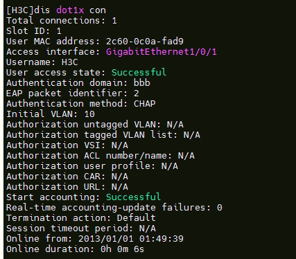

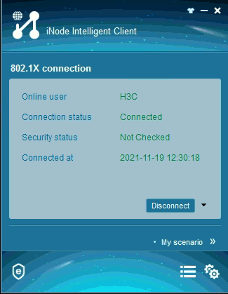

3. After modifying the user name in the 802.1x client to be consistent with the device configuration, the authentication succeeds.

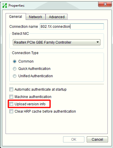

3. If  an iNode client is used, to ensure that the local authentication can be successfully performed, make sure that the "Upload version info" option in the 802.1X connection properties is not selected.
