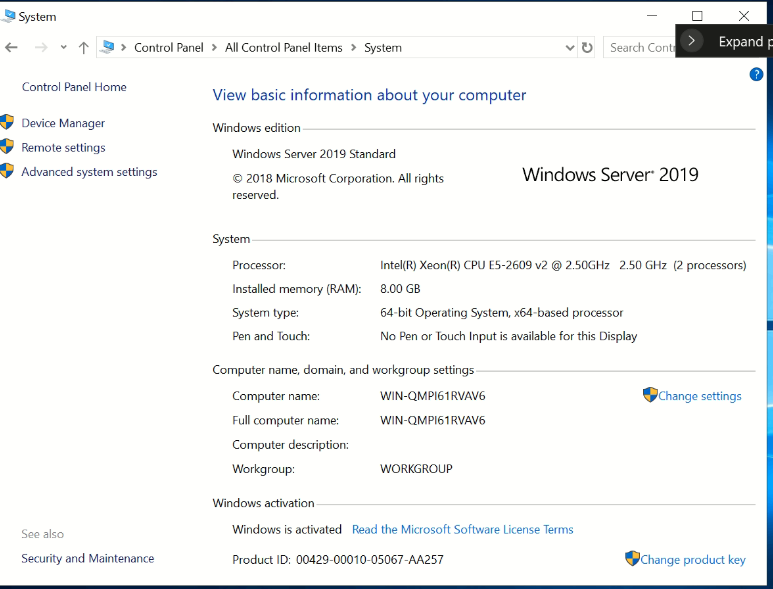

Virtual Machine platform: VMware
Operating system: Windows Server 2019

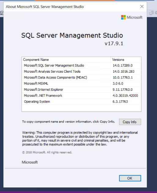

Database: MS SQLserver 2017 V17.9.1

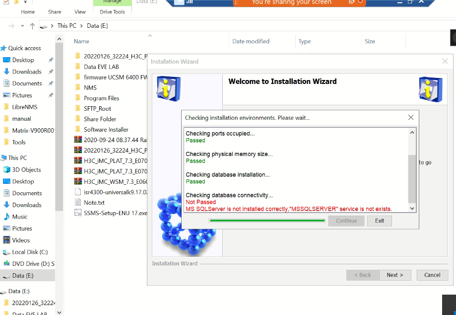

issue: When installing iMC platform, the following error occurs when connecting to the database that has been installed and configured:

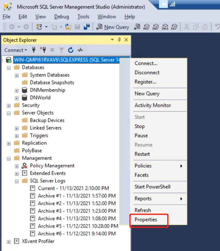

4. whether the SQLServer service is correctly opened

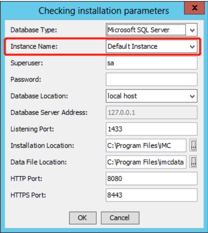

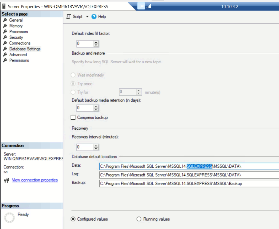

5. whether the instance name is the same as the default instance of iMC connection
By checking, the first 4 configurations are correct,in the 5th configuration, the customer has customized the instance name "SQLEXPRESS", which is not consistent with the default instance name when iMC connects to the database.
Solution
After changing the Default Instance to Other Instance and entering the customer-defined instance name "SQLEXPRESS", the problem is solved and the connection is normal.
