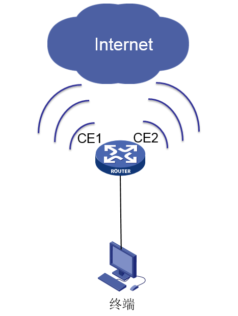

Network Topology
1
Problem Description
When the MSR810S have two uplink 4G network egress, how to achieve automatic SIM card switching?
