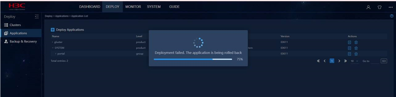

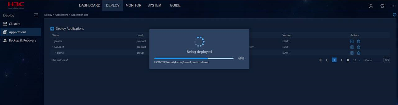

when deploying the module “general_PLAT_kernel_2.0_E0611”It stuck at 68% then it rolled back.
2022-03-28 18:07:49 Published
  • 0 Followed
  • 0Collected ,3164Browsed
Problem Description
when we are installing H3C_PLAT_2.0_E0611_x86, when deploying the module “general_PLAT_kernel_2.0_E0611”It stuck at 68% then it rolled back.
Solution
When installing general_PLAT_portal_2.0_.zip as HTTP!!! When PLAT 2.0 component is deployed as HTTPS, you cannot deploy or upgrade other components, please switch to HTTP request protocol when deploying other components .
