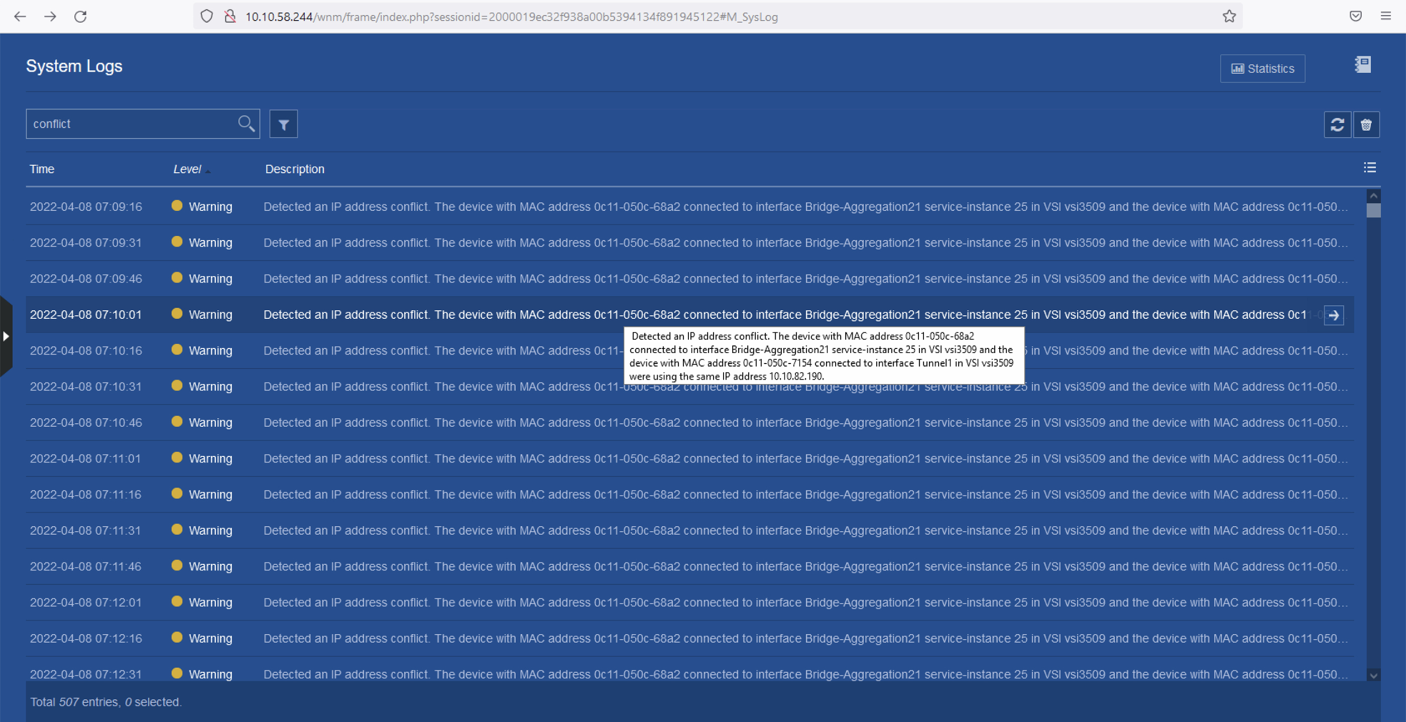

Customer recently facing some issue with the Network unstable issue while doing the Microsoft Teams Call and having voice drop issue, also they found that all H3C Leaf having duplicate IP issue.
Process Analysis
Analysis of the diagnostic information revealed a large number of ip conflicts on all leaf.
And these conflict ip addresses all correspond to different actual end devices.
