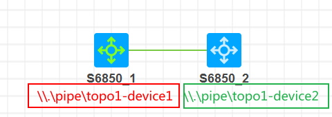

Network Topology
Open the corresponding HCL project

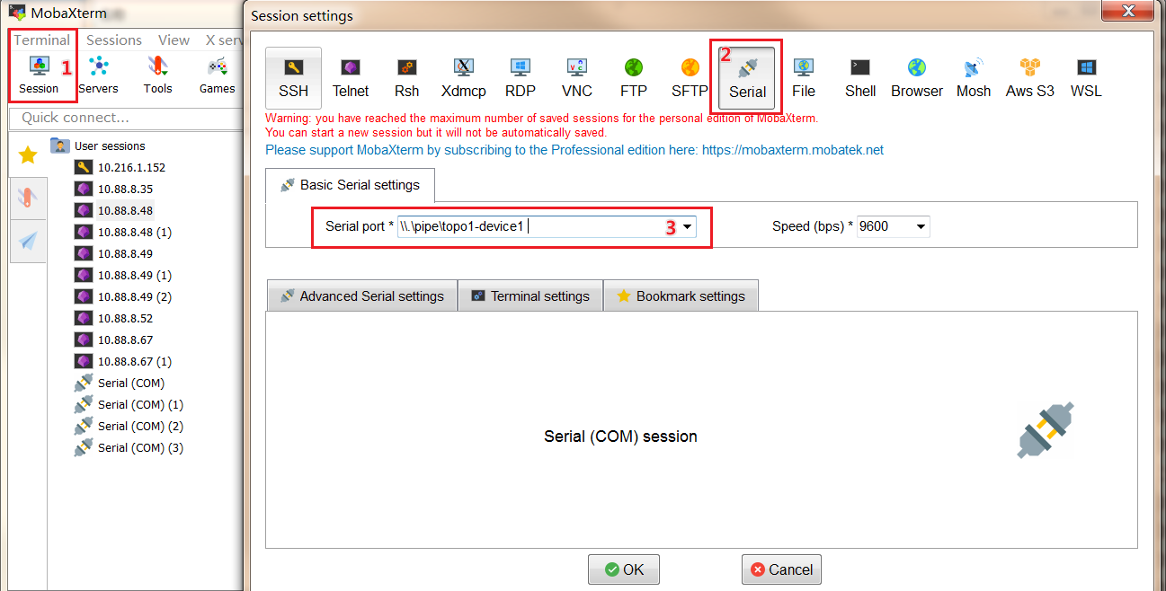

2.Open software Mobaxterm and select serial port, and input serial port : \\.\pipe\topo1-deviceX(device number)

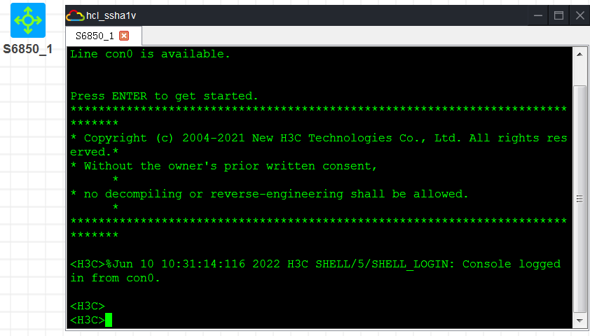

3.Click "Enter" so that we can use mobaxterm software to manage HCL device.

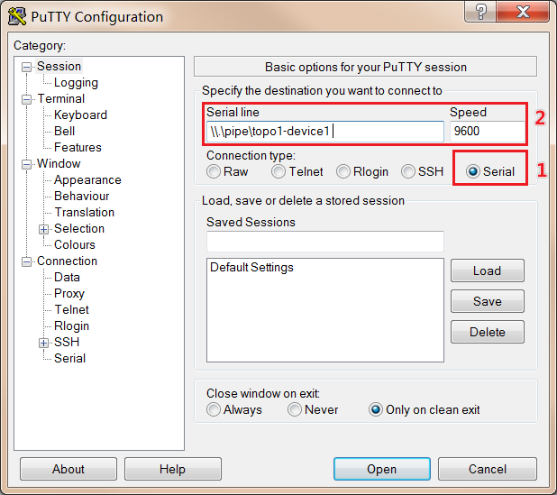

4.For putty software, the method is the same with mobxterm, please refer to following pictures:

Serial port : \\.\pipe\topo1-deviceX(device number)
