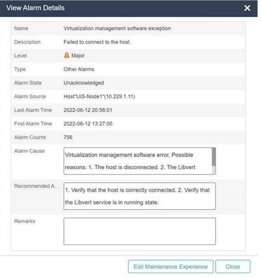

UIS web pop up alarm:
1.Virtualization management software error.
2.Arbitrator host failure alarm.

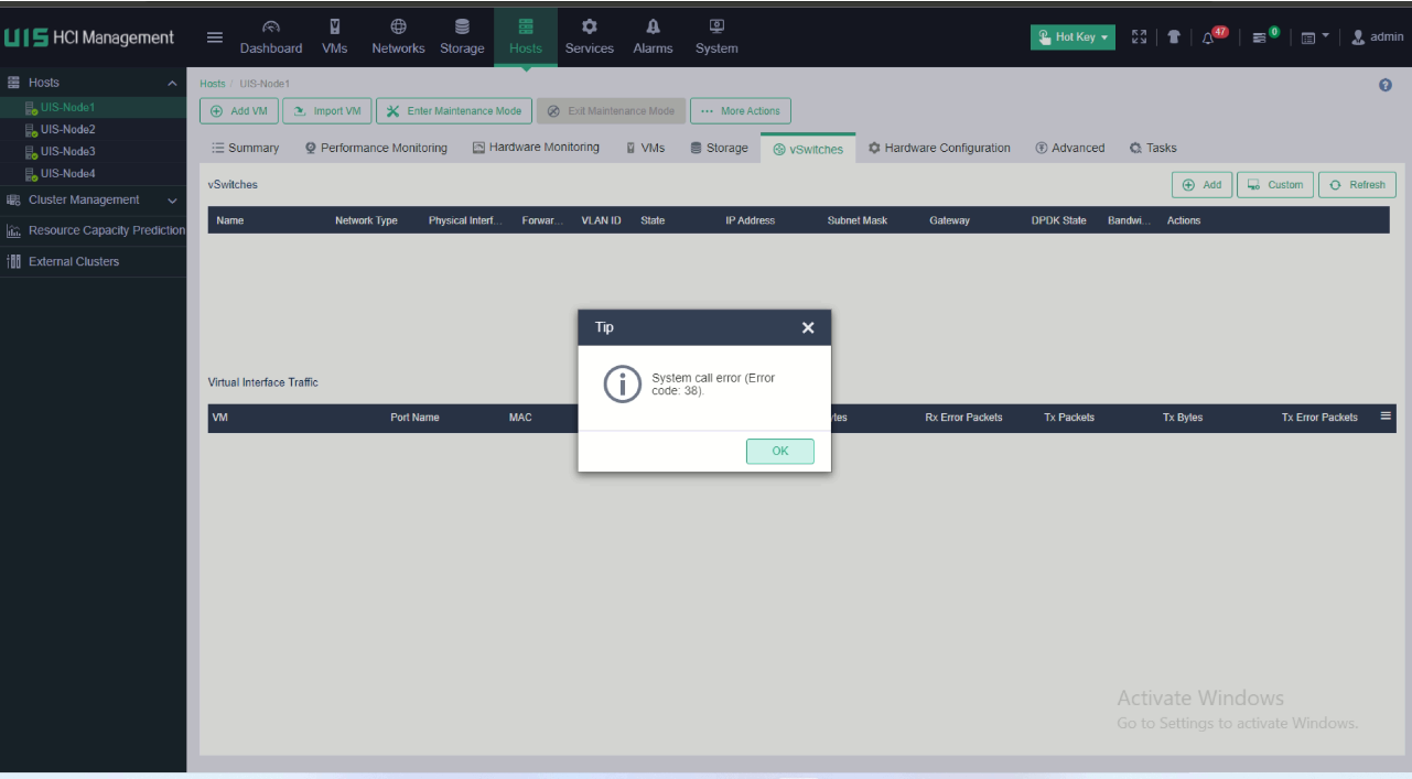

During the processing of the problem,we found that the UIS clicked on the node1 CVM node and a system response error occurred.

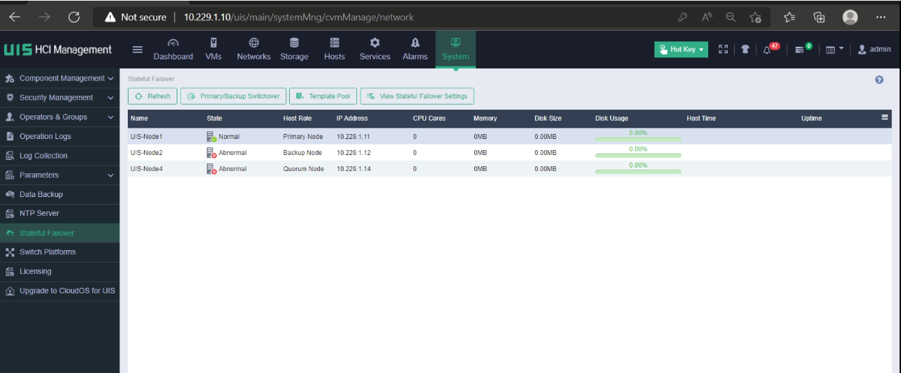

At the same time, there is also a problem with the stateful failover page

After that, the system call error no longer appears in the foreground and also it’s normal in the stateful failover page.
At the same time, the packet loss alarm is no longer generated, indicating that the previous two alarms” failed to connect to the host “and “Arbitrator host network packet loss “ on the UIS were caused by the problem of the CVM node password key, which prevented the CVM node from communicating with other cvknodes normally, and the alarms occurred.
Now everything is normal and the alarm is no longer generated.
