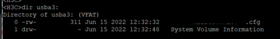

When Udisk is used to configure a router automatically, the configuration file cannot be read and the device cannot be automatically configured.[Zero Touch Provisioning].
But sometimes, the Udisk is recognized as USB:3/ rather than USB:0/

When the U disk is identified as usba3, the automatic configuration of the U disk is unsuccessful;
The situation that the U disk is recognized as usba3 should be caused by the hidden partition of the U disk, which can be solved by re-partitioning or replaing the U disk.
