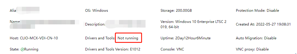

Problem Description
Problem:
1. Workspace cloud desktop platform Failed to communicate with the Agent;
2. cloud desktop Drivers and Tools: Not running.
Impact: Unable to Message Delivery, Software Repository Templates, File Distribution, Upgrade agenttools, etc. But,  you can log in to use the remote desktop service normally.

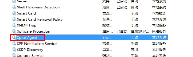

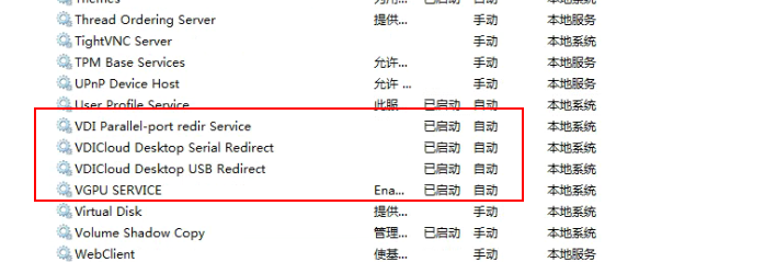

b. Check whether the service below of the VDI VM is normal. It may be affected by anti-virus software and cannot get up.
Find out why the service is not working. If a process is isolated by anti-virus software, please added it to the whitelist. If it still doesn't work, reinstall agenttools.
