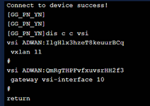

Connect to the device remotely, and view the current VSI configuration on the device through "dis c c VSI". It is found that there is a corresponding VSI on the device, but there is no corresponding tunnel configuration. Due to the repeated online and offline behavior of the field equipment and the residual VSI configuration on the equipment, the tunnel cannot be issued again.

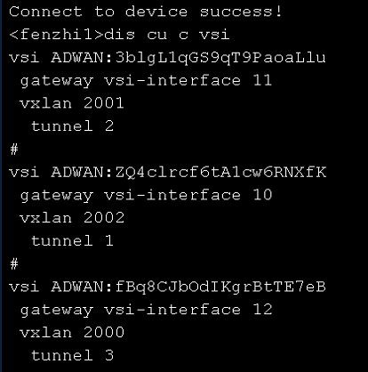

Field configuration:
Normal configuration:
