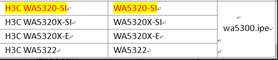

3. The AC version is R5433P03, which supports the AP model WA5320-SI
4. Since the registration is automatic, display wlan ap all can not see the status of the unlisted ap. Modify the test ap to manual registration, and check the status again to find that it has been in I
5. there is a wa5300.ipe file in the apimge folder of the AC, and the firmware-update version check has been disabled on the AC. There is also no APDB special command configured
