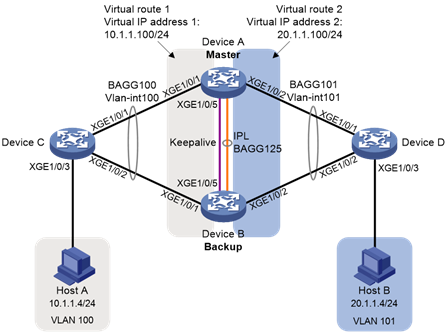

Network Topology
DRNI combined with VRRP networking
Problem Description
The DRNI configuration is normal, the VRRP status is normal, and the interfaces are all Up, but the Virtual IP is unreachable.
