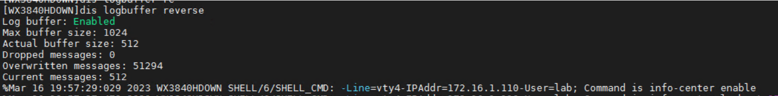

1. Configure syslog server on the network device
[H3C]info-center enable
[H3C]info-center loghost 172.16.1.77

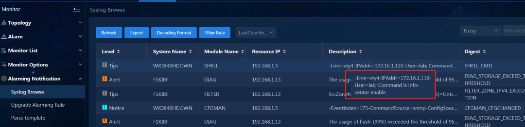

A syslog is generated on the device,for example, the log of the "info-center enable" command is executed on the device.

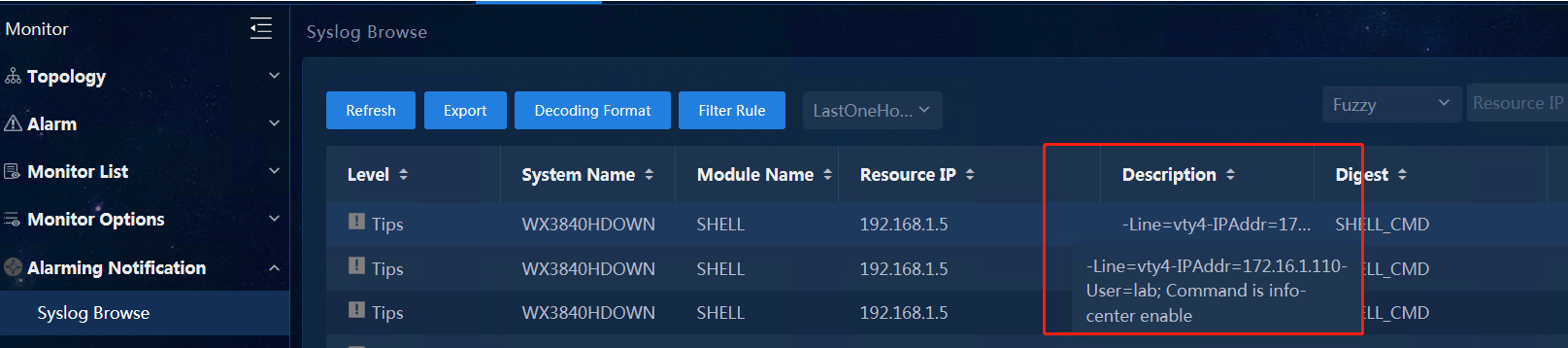

IMC Syslog Browse and receives the syslog sent by the device.

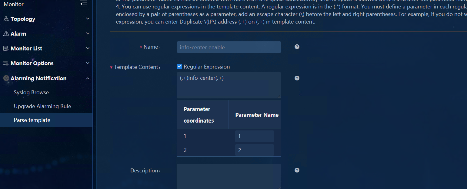

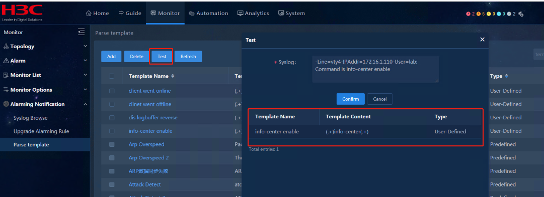

2. Firstly adding a syslog template to resolve syslog.
syslog containing "info-center" text will be matched by this template, "(.+)" is a regular expression, which means that it can match any content.
3. Copy the syslog content and test to see if it can be parsed by the syslog template.

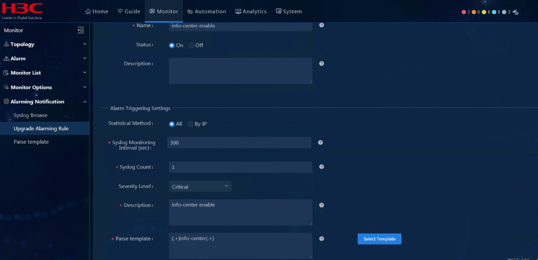

4. Create a syslog upgrade alarm rule, set the syslog count to 1, select the created analysis template, and click OK.

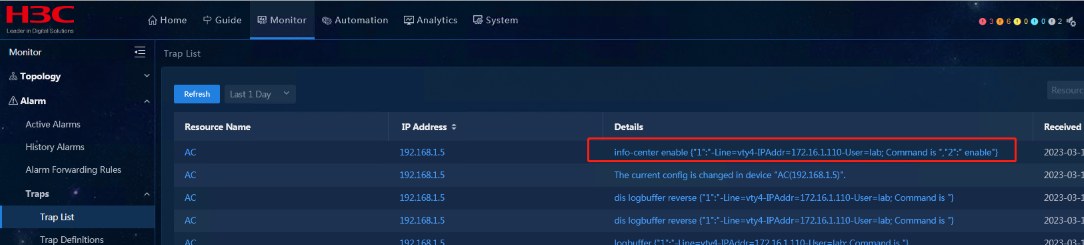

6. Syslog will generate a trap.

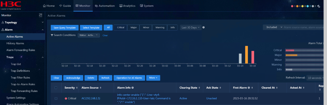

7. Trap will convert to alarm

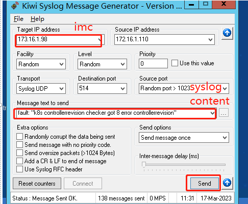

8. Tips: If there is no network device, we can also use the attached syslog generator to generate syslog and send syslog to iMC.
