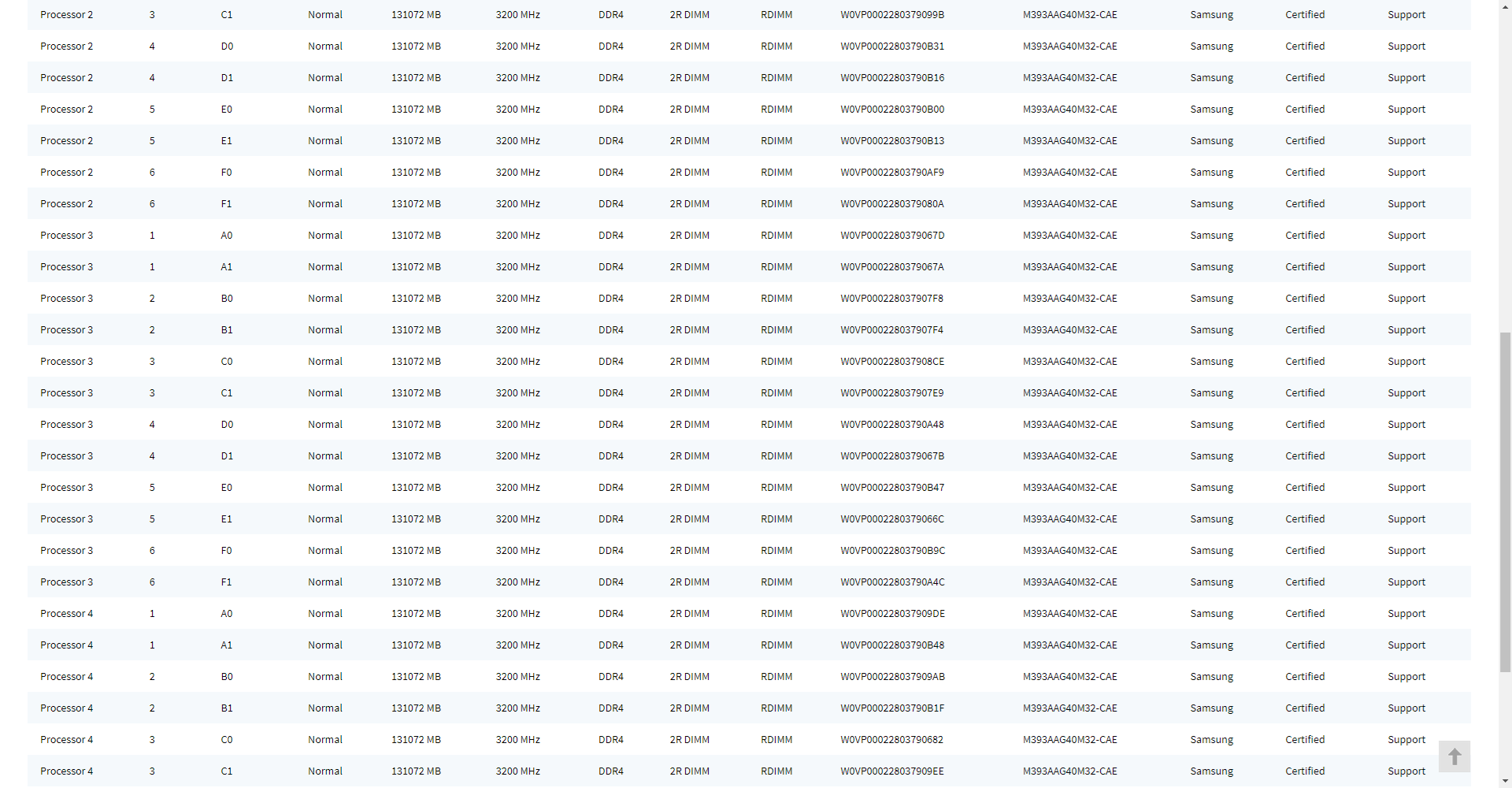

1.Remove and reinsert these 8 faulty memory and clean the goldfinger, issue resolved
2.So tell customer that  please pay attention to the server environment such as the dust.
