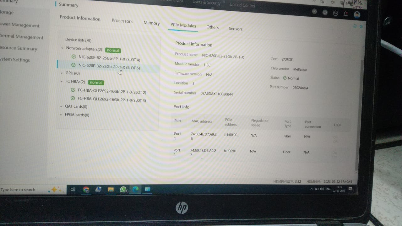

1.normal identify

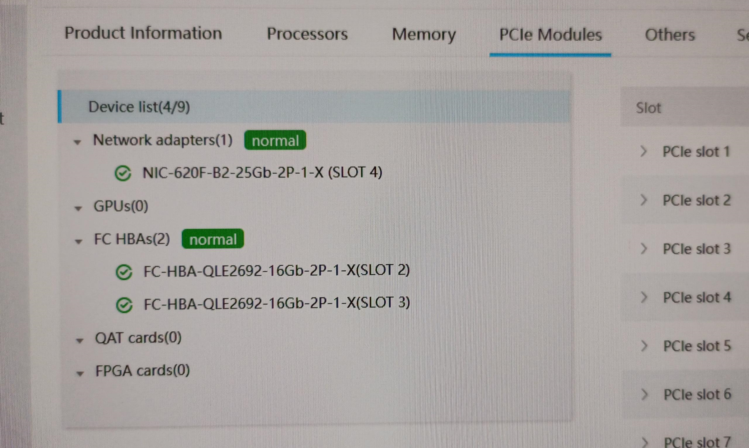

2. After the server is restarted, NIC of slot5 cannot be identified

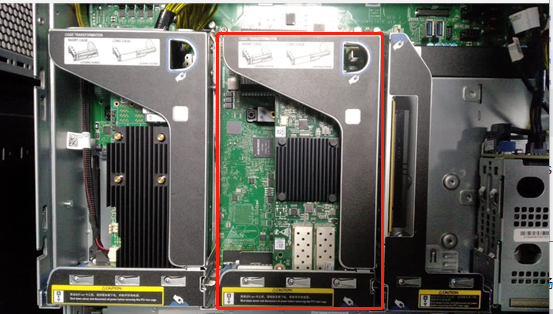

(1)Remove and reinsert the slot5 NIC. The fault persists after the server is restarted twice.
(2)Cross the NIC of slot4 and slot5 and find that slot5 is still not recognized.
2.After replacing riser2 where slot5 is located, the problem is resolved.
