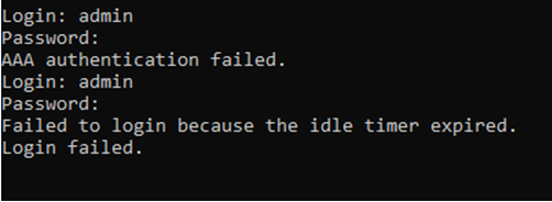

Unable to log in to device, shows idle timeout
Process Analysis
1. The feedback password input is correct, and configured password control, indeed, the probability is that the password timeout.
2.When device enable the password-control, the device will has password-control login idle-time configuration by default, and the password timeout resulted in failure to log in.

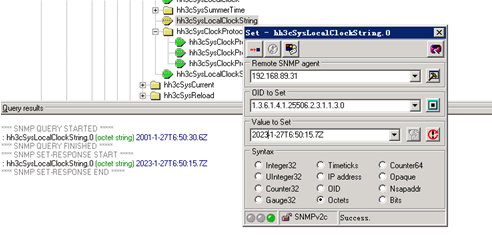

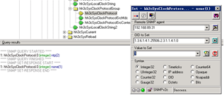

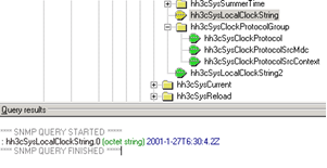

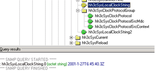

1.You can use snmp to change the time of the way, but the local time and closer will not affect the business, but the premise requires that the device is configured with snmp and open set of permissions, if there are no conditions can only reboot the device.
