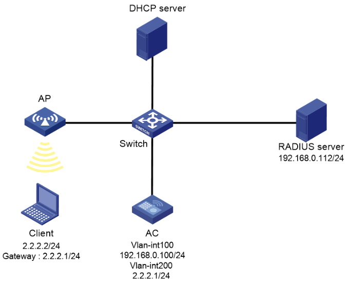

Network Topology
Typical Networking for Portal Authentication
Problem Description
The site is deployed in the wireless Portal networking mode and iMC server method for authentication. However, the portal authentication user will log out automatically after being online for a few minutes.

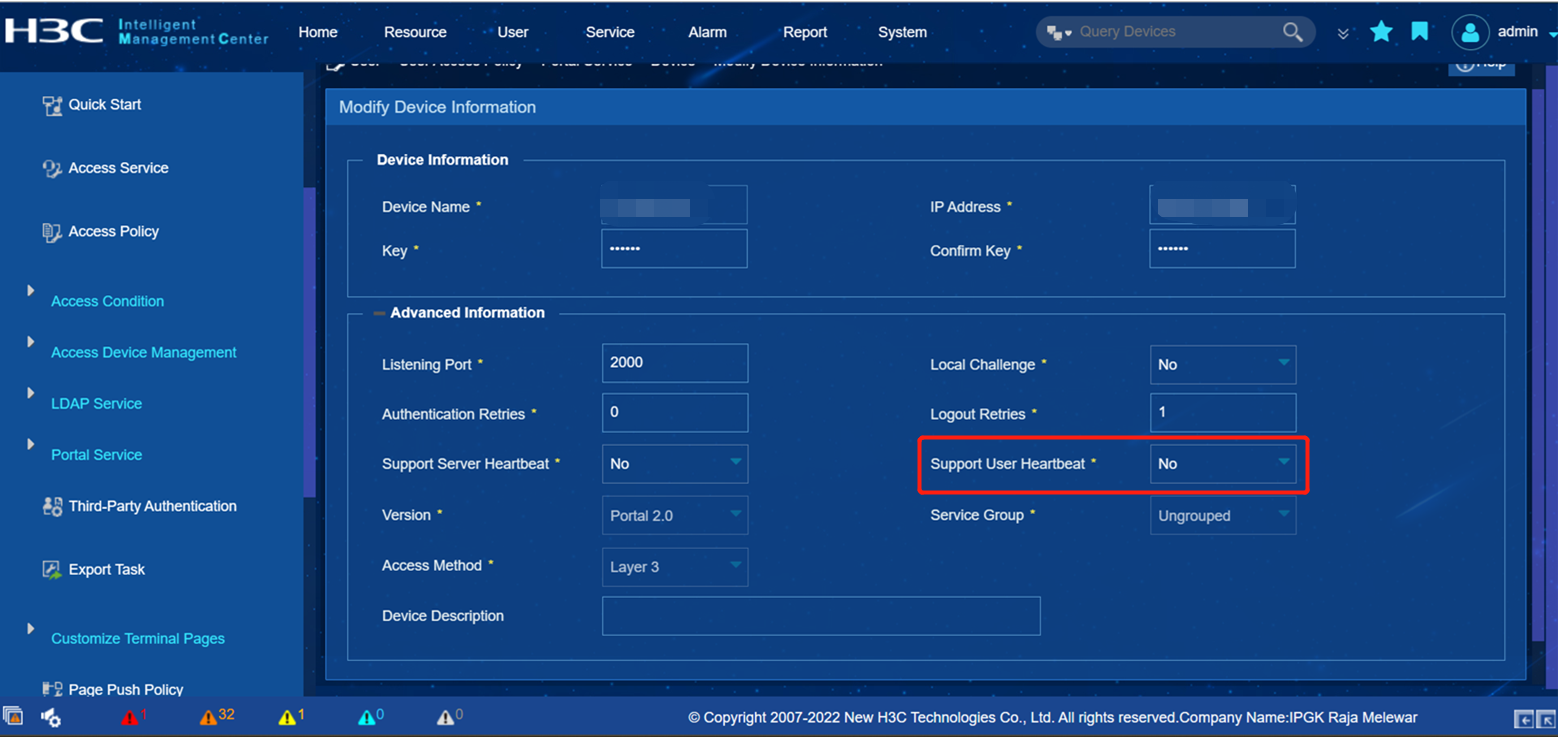

(3) After confirmation, the Support User Heartbeat function is not enabled on the imc.
Solution
The Portal User information sync function has been configured on the AC.
This function must be enabled at the same time as the User Heartbeat function on the iMC.
