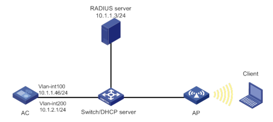

Network Topology
Common remote 802.1X authentication network topology:
