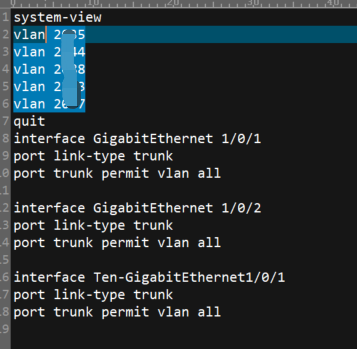

After the AP is online, it is found that the AP can get the address, but the terminal cannot get the address. The vlan of the terminal is configured on the AP, and this vlan-interface can get the address normally.

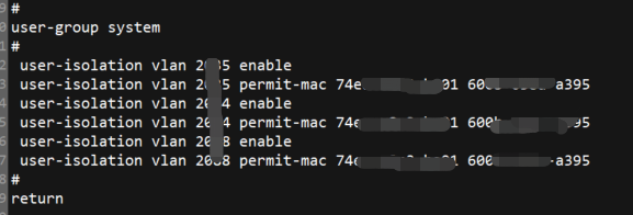

3. Confirm that the site is configured for user isolation, but in the MAP file, the corresponding configuration has been deleted.
4. Check the AP configuration and find that the corresponding configuration does not match the map file
Solution
1. delete or modify the configuration of user isolation on the AP to change the corresponding MAC to the new switch mac after replacement
2. Get the AP offline and online again to reacquire the MAP file.
