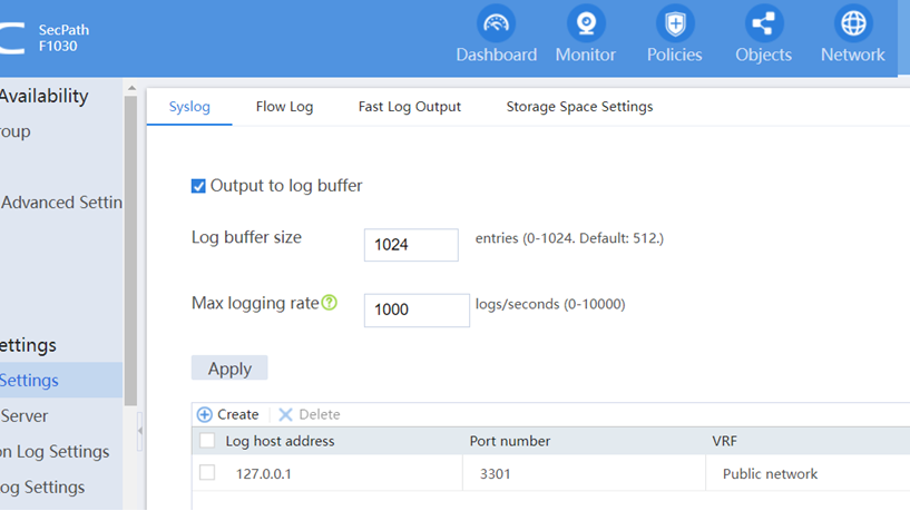

  1. Check the log configuration are as following:

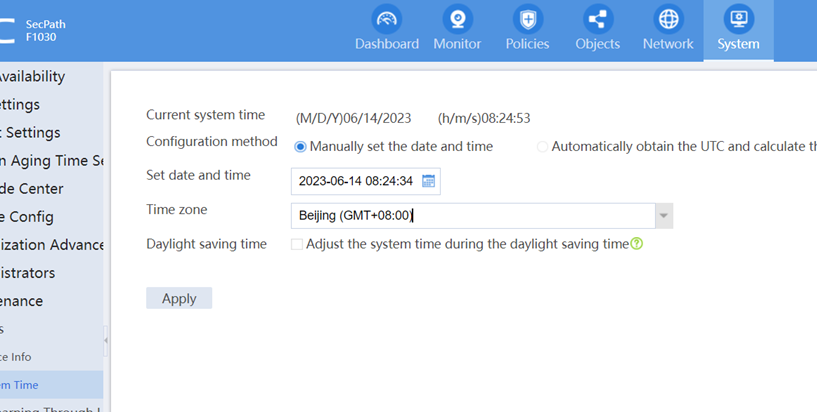

  2. Make sure the system time is correct based on your local time and time zone.

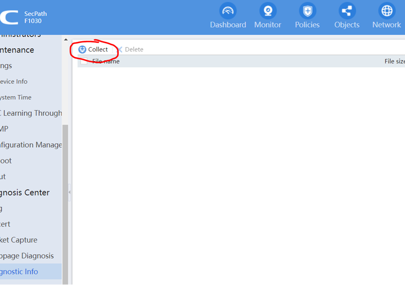

3. And after check the configuration above, if there is log in the buffer, but still no log on the GUI. Please feedback the diag info of your device.
Solution
If you still can't see the syslog on the GUI, please feedback the diag info of your device to the TSC for supporting.
