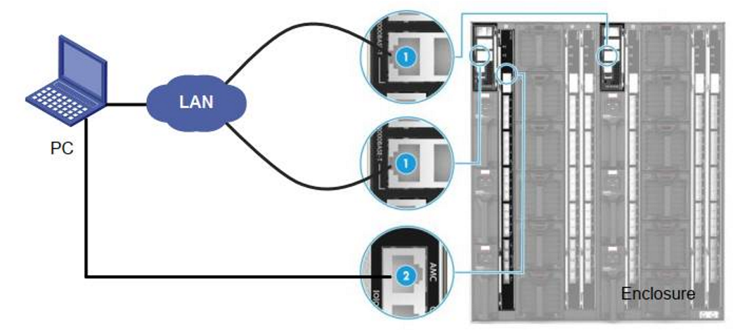

Step1: Connect the PC console port to the console port of the AMC of the interconnect module via a console cable; connect the PC Ethernet port to the management network of the OM module via a network cable.
 ① Interconnection module management port ;② Interconnection module AMC Console port

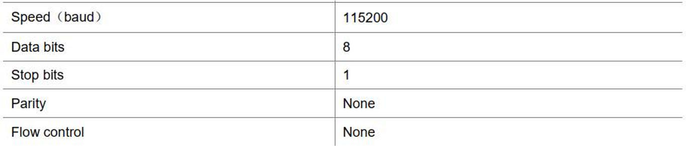

1) Use remote login software, such as putty, MobaXterm, to set up the ACL console port and login to the AMC CLI.
2) After logging in through the AMC console port, press "Enter" and enter your AMC CLI username and password (username is admin by default, password is empty by default).
