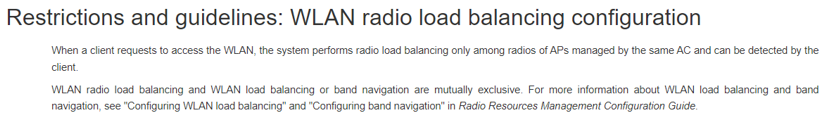

Will these two types of load balancing conflict? We got the answer by looking at the configuration guide. Official website link: https://www.h3c.com/en/d_202209/1697108_294551_0.htm
So far, we have found the root cause of the on-site problem. At the same time, after deleting the traditional load balancing configuration on site, the dual 5G load balancing takes effect.
