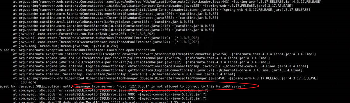

2. Check the front-end logs in /var/log/tomcat/cas.log. The logs indicate an error message stating that the local address 127.0.0.1 cannot connect to the database.
3. Attempted to manually connect to the database according to instructions, but the same error message occurs.
