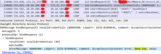

*Apr 20 10:18:43:277 2021 Wireless Controller LDAP/7/EVENT:
PAM_LDAP: Get result message errno = 49
*Apr 20 10:18:43:277 2021 Wireless Controller LDAP/7/ERROR:
PAM_LDAP: Failed to perform binding operation as user.
The server replies with an error reason code 49, indicating authentication failure. The specific failure information needs to be checked from the captured packets.
Packet capture is performed between AC and LDAP, and the error code is found to be 52e, indicating that the password or credential is invalid. Therefore, it is recommended to check the username and password configuration on-site.

Solution
Check the username and password configured on the ldap server, and the failure is resolved after checking again to enter the username and password.
