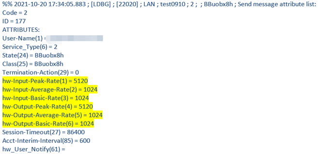

The server logs show that the speed limit policy was issued normally:

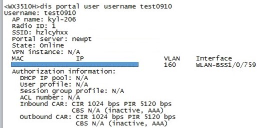

Viewing the portal user table entry on the device shows AAA downlink failure: inactive AAA
Further check the device log information and found that the server configuration speed limit is too low at 1bps, which is not within the reasonable range of the device.

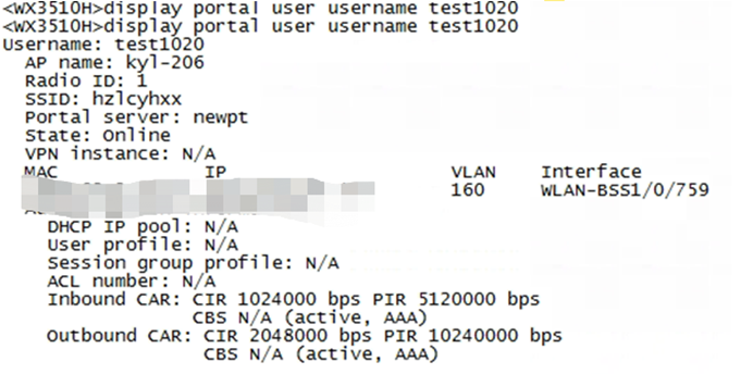

The speed limit takes effect when the server speed limit is modified to a value within the range supported by the device: active AAA
Solution
The server speed limit value is to be configured within the range allowed by the device to be configured: 8*103-10*1010bps
