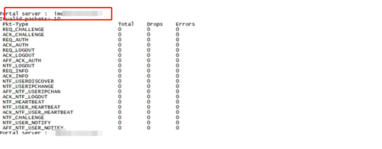

(5) Using the command "display portal packet statistics" on the AC, it was found that the statistics of invalid portal packets continued to increase.
(6) Usually, in this kind of situation, either the terminal address is incorrect, or the key used by the portal server on the AC is inconsistent with that on the server. By analyzing the captured packets on-site, it was confirmed that the terminal IP address was correct and the problem was solved by reconfiguring the key.
