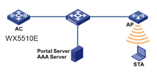

Network Topology
In a traditional network environment, the portal server is a third-party server, and the versions used are all the latest versions from the official website

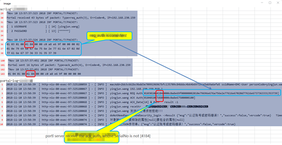

In the production environment, after the server has been running for a period of time, the serial number that is generated in the (ACK_AUTH message) between the AC and the portal server during the same authentication process is not consistent, but users are still able to successfully go online.
Process Analysis
First, an analysis of the logs for the AC and portal server reveals the following characteristics:
It was discovered that the logs for the AC were consistently normal, but after the third-party portal server had been running for a period of time, the serial number that was received in the ACK_AUTH message on the portal server was different from the serial number in the REQ_AUTH message. It is suspected that the third-party server is having issues parsing the portal messages from our company. The on-site feedback was that the third-party server is using the portal 1.0 protocol, while our AC is using the portal 2.0 protocol, which is also backward compatible with portal 1.0. After attempting to test with the third-party server modified to use the portal 2.0 protocol, the following issues were encountered:
