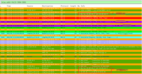

After constructing an unencrypted environment, we continue our packet capture and analysis, resulting in the following findings:
It was found that the terminal will perform a unicast ARP to query the gateway's address before experiencing abnormal disconnection. However, it seems that it did not receive a response, and then triggered the abnormal Deauth after not receiving a response for 1 second. We found this pattern in multiple tests as well. After the abnormal Deauth, the terminal started to reconnect, and this process was similar to when the terminal first came online. During the DHCP process, the terminal also sent ARP, but in a broadcast manner, and there were responses to the broadcast ARP.
We also captured the roaming behavior of other devices such as smartphones, which also sent unicast ARP queries to the gateway after roaming without receiving a response, but did not experience abnormal disconnection.
Based on this, we can conclude that the PDA has a special judgment mechanism. After roaming, it will send a unicast ARP query to the gateway. If it does not receive a response within 1 second, the PDA will consider the network to be unavailable, and will disconnect from the Wi-Fi and try to reconnect after 3 seconds, triggering the DHCP process as if it was the first time connecting. However, broadcast ARP can be correctly responded to in this network.
