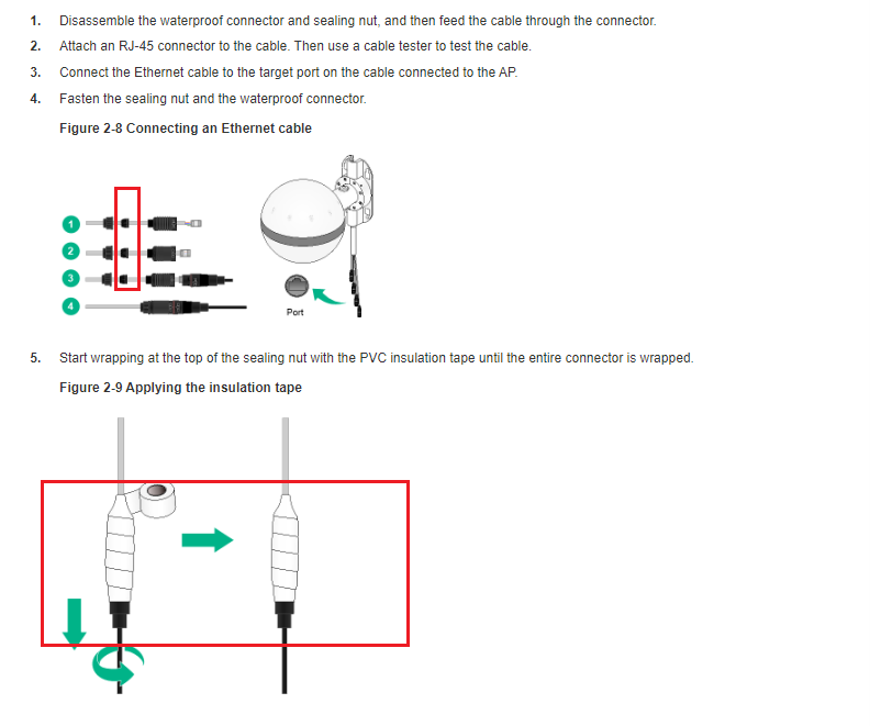

Problem Description
Be sure to install a waterproof rubber plug on the ball AP to prevent water infiltration.
Solution
When the ball AP is connected to the Ethernet cable, do not remove the waterproof rubber plug of the network cable. At the same time, wrap a layer of PVC insulating tape on the head of the sealing nut from top to bottom, and then wrap three layers of waterproof tape on the outside of the PVC insulating tape. Tape, which needs to completely cover the entire waterproof joint. Prevent water from entering the cable and causing a short circuit on the network cable.
Document link:https://www.h3c.com/en/d_202301/1763332_294551_0.htm
