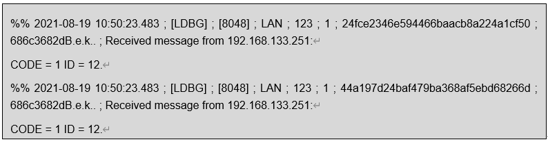

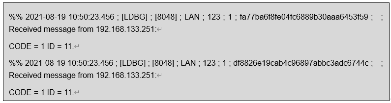

1) The server received two identical EAP No.1 messages at the same time.
2) The server received EAP message number 2 at two different times.
The server will receive two identical messages at the same time, which will result in the server thinking that the message is abnormal and replying to reject. In the case where the server receives two identical messages at the same time, it may be due to the configuration of mirrors in the device. As a result of layer by layer investigation, it was found that there is a mirror group configured on the switch connected to the authentication server. This mirror group causes two identical authentication messages sent by the device to the server, which is considered abnormal for the server and therefore authentication will be rejected.
