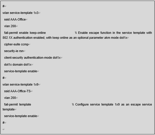

3)     Escape service template method. When users use 802.1X authentication to access the network, use the fail permit template command to configure the escape service template in advance. When an escape occurs, the user service will be switched to the escape service template, and it is necessary to manually reconnect to the escape service template network before continuing to access the network.

1)     When users use 802.1X authentication to access the network, use the fail permit template command to configure the escape service template in advance. When an escape occurs, the user service will be switched to the escape service template. The escape service template is automatically enabled, but the terminal needs to manually reconnect to the escape service template before continuing to access the network.
2)     The wireless service template used after escape and the wireless service template with 802.1X authentication enabled are two different service templates. The client security authentication location, client forwarding location, and client association location parameters configured under these two wireless service templates must be consistent.

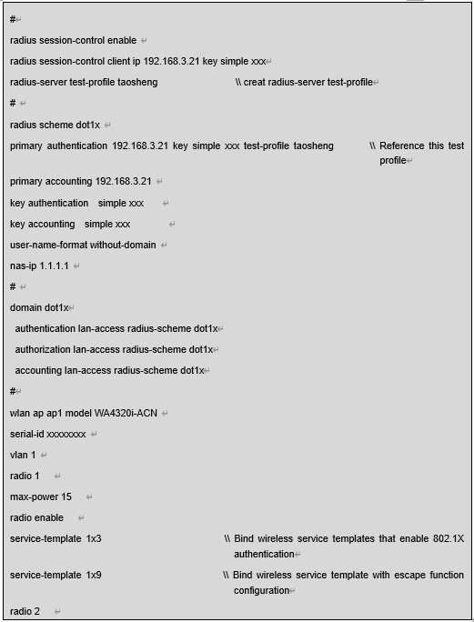

3)     To successfully escape, users must configure the RADIUS server detection template through the radius server test profile command. When it is detected that the RADIUS server is unreachable, users can escape. At the same time, it is recommended to configure the period for sending detection messages according to the actual situation. The shorter the period, the faster the response.
4)     It is recommended to configure only one 802.1X authentication escape service template in the system. If multiple templates are configured, the first escape service template bound to Radio will take effect. It is recommended to configure the 802.1X authentication escape service template with AKM mode set to psk mode or without AKM mode, otherwise it may cause escape failure.
