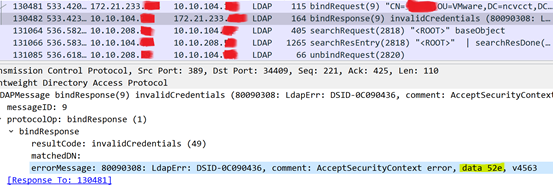

The server replies with an error reason code 49, indicating authentication failure. The specific failure information needs to be checked from the captured packets.
Packet capture is performed between AC and LDAP, and the error code is found to be 52e, indicating that the password or credential is invalid. Therefore, it is recommended to check the username and password configuration on-site.
Explanation of common error codes:
525 - User does not exist
52e - Password or credentials are invalid
530 - Login not permitted at this time
531 - Login not permitted at this workstation
532 - Password has expired
533 - Account is disabled
701 - Account has expire
773 - User must reset password
775 - User account is locked
Solution
Check the username and password configured on the ldap server, and the failure is resolved after checking again to enter the username and password.
