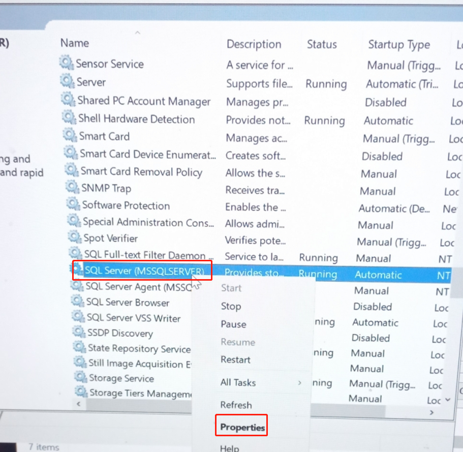

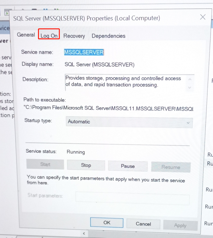

Log in to the IMC server desktop, click Configuration-Services in the Server Manager (Computer-Management), find MSSQLSERVER, right-click Properties, and select the login identity as "Local System Account" in the Login Options tab, as shown in the following figure:
After completion, restart the MSSQLSERVER service and reinstall iMC.
