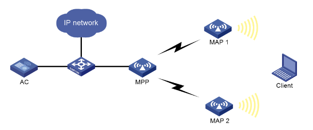

Network Topology
AP03(MPP) —— FIT mode
AP05(MAP) —— FAT mode
AP06(MAP)—— FIT mode
Problem Description
AP3 establishes a mesh link with AP5 and AP6 through radio1, and after the establishment, AP03 will be down automatically, and it can be recovered only by restarting the PoE interconnect interface of AP3. However, after the recovery is completed, AP03 will automatically go down again after a while, and the Idle state can only be recovered by rebooting.
