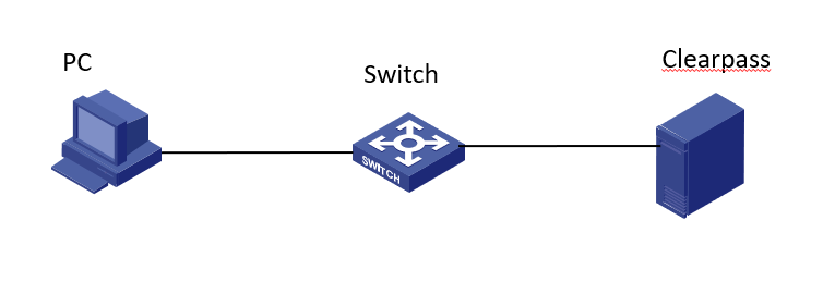

Network Topology
Topo:

ClearPass acts as the RADIUS server. Users perform 802.1X EAP authentication and phones perform MAC authentication. The PC starts with 802.1X authentication but fails. Users are authenticated and have access, but after 110 seconds they are disconnected. ClearPass shows Lost-Carrier as the termination cause.
