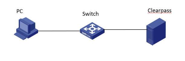

Network Topology
Topo
Problem Description
ClearPass acts as the RADIUS server. Users perform 802.1X EAP authentication and phones perform MAC authentication. The PC starts with 802.1X authentication, ​​however, the windows terminal will trigger dot1x authentication multiple times
