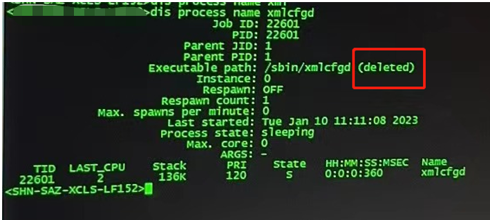

1. Viewing the switch logs shows the xmlcfgd process abnormally alarmed
 %Aug 7 18:41:03:723 2023 H3C SCMD/4/PROCESS_ABNORMAL: The process xmlcfgd exited abnormally. ServiceName=XMLCFGD, ExitCode=1, KillSignal=NA, StartTime=2023-08-07 18:41:02, StopTime=2023-08-07 18:41:03. StartTime=2023-08-07 18:41:02, StopTime=2023-08-07 18:41:03.
 %Aug 7 18:41:04:833 2023 H3C SCMD/4/PROCESS_ABNORMAL: The process xmlcfgd exited abnormally. ServiceName=XMLCFGD, ExitCode=1, KillSignal=NA, StartTime=2023-08-07 18:41:02, StopTime=2023-08-07 18:41:03. StartTime=2023-08-07 18:41:03, StopTime=2023-08-07 18:41:04.
 %Aug 7 18:41:05:929 2023 H3C SCMD/4/PROCESS_ABNORMAL: The process xmlcfgd exited abnormally. ServiceName=XMLCFGD, ExitCode=1, KillSignal=NA, StartTime=2023-08-07 18:41:03, StopTime=2023-08-07 18:41:04. ServiceName=XMLCFGD, ExitCode=1, KillSignal=NA, StartTime=2023-08-07 18:41:04, StopTime=2023-08-07 18:41:05.

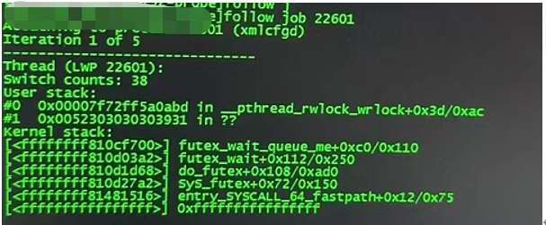

2. check xmlcfgd process, did not start normally, the scene of the previous patch through the controller on January 10, fork xmlcfgd sub-process deadlock did not exit (does not affect the patch function), resulting in this time xmlcfgd startup lipc port is occupied by the residual process startup failure:
Looking at the log there is also a record of the patch installation, the time can be right
%@19848%Jan 10 11:08:04:512 2023 H3C FTP/5/OPER: User sdnadmin@17.251.12.68 uploaded flash:/d65033ec-f0d5-42d5-8dee-e18a8c0fe87e.bin.
 %@19861%Jan 10 11:13:03:261 2023 H3C XMLSOAP/6/ACTION: User (sdnadmin, 17.251.12.68, session ID 9), message ID=1, operation=action Package/ InstallImage, result=Succeeded. attributes: Action=1, PatchFile="slot1#flash:/d65033ec-f0d5-42d5-8dee-e18a8c0fe87e.bin", OverwriteLocalFile=true.
Solution
The current version of the device when deploying patches through the controller, a small probability of triggering fork xmlcfgd sub-process deadlock did not exit, when the subsequent xmlcfgd process restart can not start normally, this problem is planned to be solved through the R6635H17 patch
