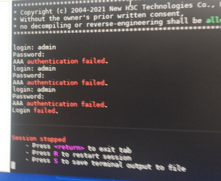

Problem Description
Failure to use telnet remote method, prompting AAA authentication failure.

2. Then debug telnet server and debug radius packet, found that the address of radius server is unreachable.
*Aug 26 01:59:03:101 2020 H3C RADIUS/7/EVENT:
Response timed out.
Found request context, dstIP: 172.16.xxx.xxx; dstPort: 1812; VPN instance: --(public); socketfd: 28; pktID:175.
Retransmitting request packet, currentTries: 2, maxTries: 3.
*Aug 26 01:59:06:101 2020 H3C RADIUS/7/EVENT:
3. Check the configuration has
domain default enable xxxx.com.en
The default domain has been changed to a business-related domain and needs to be changed back to system.
Solution
Change domain default enable ceri.com.cn to domain default enable system.
