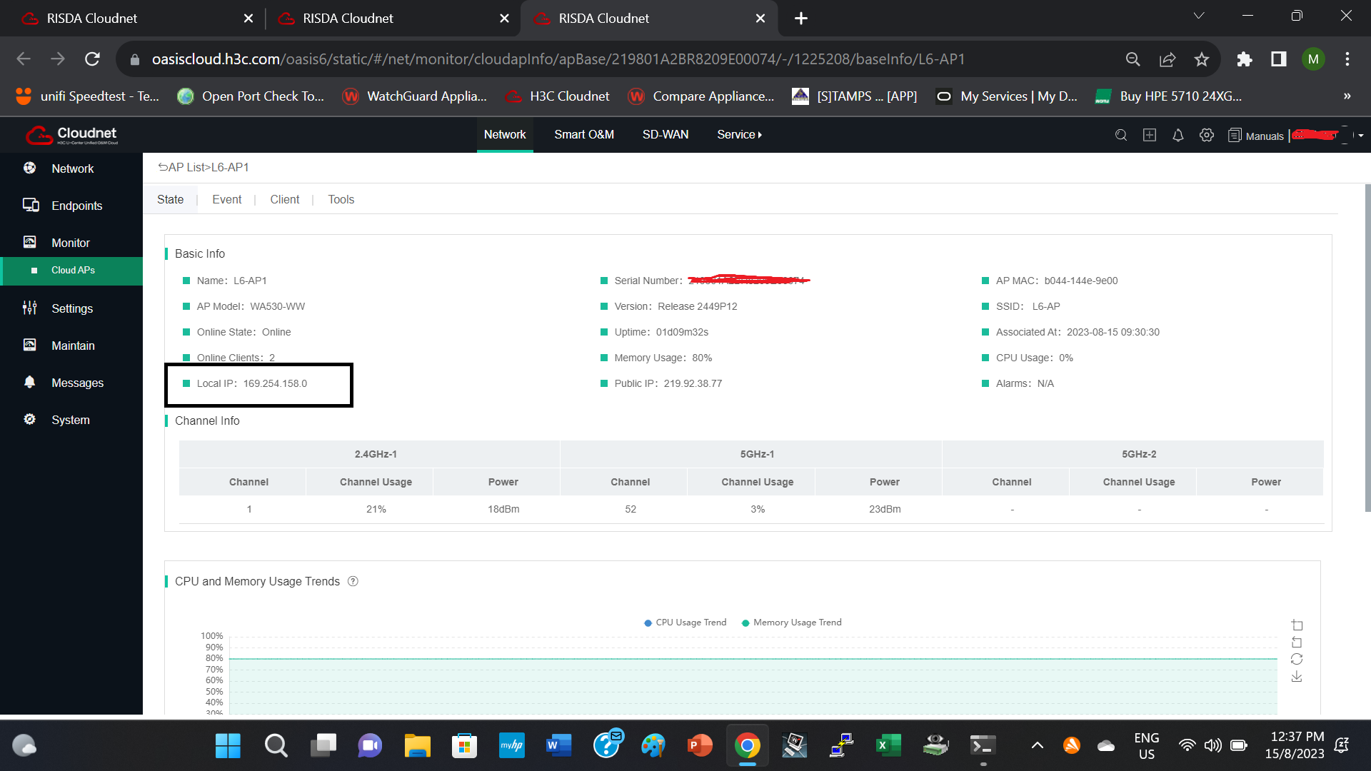

Problem Description
The local IP of the cloud AP on the cloudnet shows 169.254.158.0.
Process Analysis
The AP can only send and receive the protocal message via interface vlan 1. If the management IP is not on the vlan 1, and there is no IP on the interface vlan 1. The local IP would be showed as 169.254.158.0.

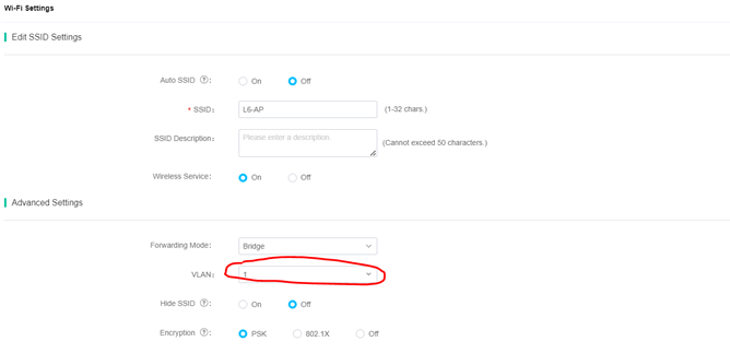

>For service Vlan and Mgmt VLAN is the same (VLAN6).
Workround:
Set the pvid of the port of access switch as vlan 6. And set the vlan as vlan 1 on the wifi-setting on the cloudnet for the AP.

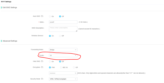

>But for Service VLAN(etc VLAN 15) and Mgmt Vlan (VLAN6) are different.
Workround:
Set the pvid of the port of access switch as vlan 6. And set the vlan as vlan 15 on the wifi-setting on the cloudnet for the AP.
