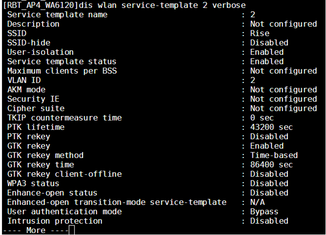

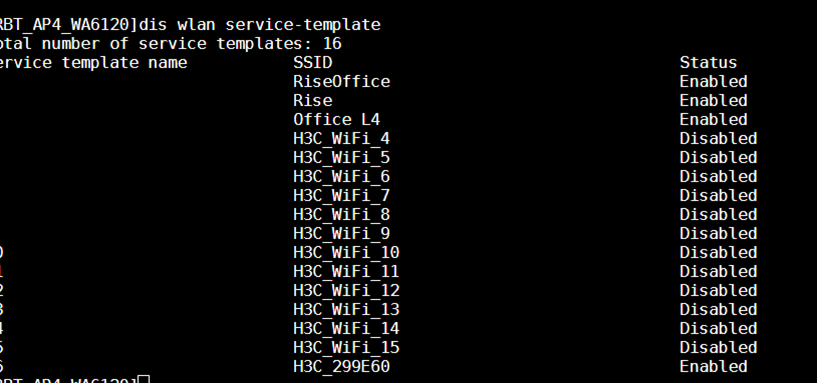

Customer did configure User Isolation on SSID on cloudnet as below
This configuration is applied on device successfully
However, as feedback from customer, this function does not work.
