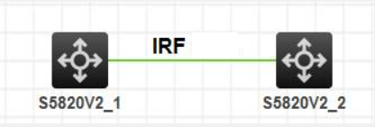

Original network:

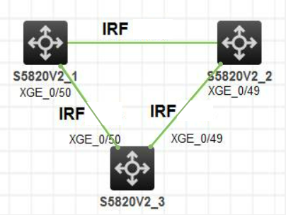

Target network:

Two switch devicesTwo switch devices are used as convergence devices and are configured with IRF2.0 features. Due to business requirements, the devices need to be expanded to a 3-device IRF system.
The expansion of member devices is required without affecting the existing network services.
Process Analysis
Step 1: First upgrade the version of the Switch to the version of the existing IRF system.
Step 2: Modify the IRF configuration of the existing IRF system, and add the physical ports connecting the 5820V2_3 devices to the IRF logical ports.
[S5820V2IRF] interface ten-gigabitethernet 1/0/50
[S5820V2IRF-Ten-GigabitEthernet1/0/50] shutdown
[S5820V2IRF-Ten-GigabitEthernet1/0/50] quit
[S5820V2IRF] irf-port 1/2
[S5820V2IRF-irf-port1/2] port group interface ten-gigabitethernet 1/0/50
[S5820V2IRF-irf-port1/2] quit
[S5820V2IRF-Ten-GigabitEthernet1/0/50] undo shutdown
[S5820V2IRF] interface ten-gigabitethernet 2/0/49
[S5820V2IRF-Ten-GigabitEthernet2/0/49] shutdown
[S5820V2IRF-Ten-GigabitEthernet2/0/49] quit
[S5820V2IRF] irf-port 2/1
[S5820V2IRF-irf-port2/1] port group interface ten-gigabitethernet 2/0/49
[S5820V2IRF-irf-port2/1] quit
[S5820V2IRF-Ten-GigabitEthernet2/0/49] undo shutdown
[S5820V2IRF] save
[S5820V2IRF] irf-port-configuration active
Step 3: Configure the IRF-related configuration of the newly added device, and modify the IRF member id of the device to add the relevant port to the IRF logical port.
< S5820V2_3> system-view
[S5820V2_3] irf member 1 renumber 3
Warning: Renumbering the member ID may result in configuration change or loss. continue? [Y/N]:y
[S5820V2_3]
Configure the irf logical and physical ports after the device reboot completes.
[S5820V2_3] interface ten-gigabitethernet 3/0/50
[S5820V2_3-Ten-GigabitEthernet3/0/50] shutdown
[S5820V2_3-Ten-GigabitEthernet3/0/50] quit
[S5820V2_3] irf-port 3/1
[S5820V2_3-irf-port3/1] port group interface ten-gigabitethernet 3/0/50
[S5820V2_3-irf-port3/1] quit
[S5820V2_3-Ten-GigabitEthernet3/0/25] undo shutdown
[S5820V2_3] interface ten-gigabitethernet 3/0/49
[S5820V2_3-Ten-GigabitEthernet3/0/49] shutdown
[S5820V2_3-Ten-GigabitEthernet3/0/49] quit
[S5820V2_3] irf-port 3/2
[S5820V2_3-irf-port3/2] port group interface ten-gigabitethernet 3/0/49
[S5820V2_3-irf-port3/2] quit
[S5820V2_3-Ten-GigabitEthernet3/0/49] undo shutdown
[S5820V2_3] save
[S5820V2_3] irf-port-configuration active
Step 4: Power down the S5820V2_3 device.
Step 5: Interconnect the IRF3/1 IRF3/2 ports of the S5820V2_3 device with the IRF 1/2 IRF2/1 ports of the peer device respectively.
Step 6: Power up the S5820V2_3 device. Three devices should exist in the IRF system after the device boots up. Configure the ports on slot 3 and save the configuration.
