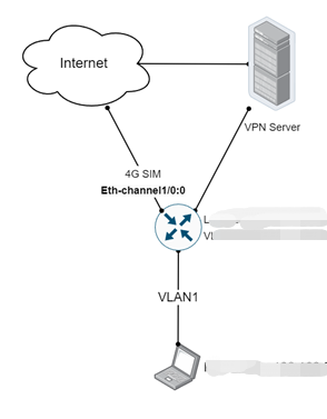

Network Topology
The router can access the Internet through dial-up, and the next hop in the routing table is the VPN Server.

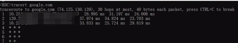

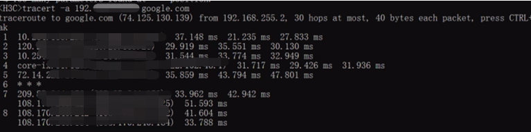

3. Tried to ping 8.8.8.8 and found that direct ping can not ping through, can only ping through 8.8.8.8 with source loop0 address.
4. Tried to trace the packet path and find that the packet is discarded on one device during direct ping. After investigation, it is because the customer has set restrictions on the VPN server. Only the address with the source address of loopback can be passed through, and the address used for direct ping is the Eth interface address.
Direct Ping:
Loopback0 address as the source to Ping:
