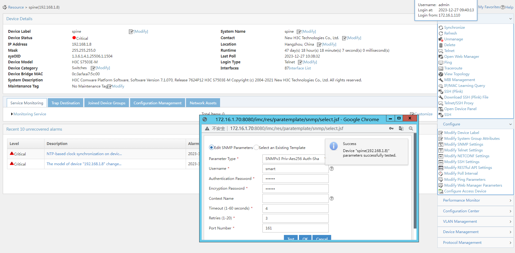

2. Configure iMC
Select the parameter type SNMPv3 Pri-Des,Auth-Sha, and input the authentication and encryption password.
Click test and it will show test successfully.
