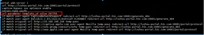

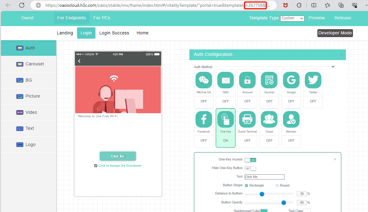

3. When changing Portal authentication-related settings (for example, changing the mac-authentication duration will not send relevant commands to the device). Because the configurations in the authentication template are stored in the cloud, you only need to issue the template_id to the device. During authentication, the device brings template_id and queries the corresponding authentication configuration through template_id.
Client-side:
Cloudnet-side:
